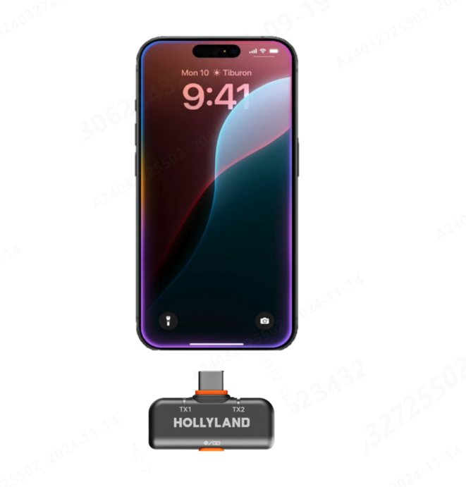

Phone Connection
1. Phone Connection (For Android)
USB-C device Connection
1. Plug the receiver to the phone. It is connected successfully if the light turn on.
2. You can download [LarkSound] APP to set the parameter.
Note: For OPPO, VIVO, OnePlus phone may need to turn on the [OTG] function, and set the Mic Option to [External Mic]
2. Phone Connection (For iOS)
For USB-C (iphone 15 and above series)
1. After powering on all devices, connect the RX to the phone. Once the indicator light is on, you can use it normally.
2. Download LarkSound APP from the app store for microphone parameter adjustment, you can adjust the microphone output volume, noise reduction level and external amplifier settings, etc.
Support Iphone 15 and above Type-C interface.
For Lightning (iphone14 and below series)
1.After powering on all devices, connect the RX to the phone. Once the indicator light is on, you can use it normally.
For iPhones 14 and earlier, only the Camera Version RX is supported, connecting to the phone using a USB-C to Lightning cable.
