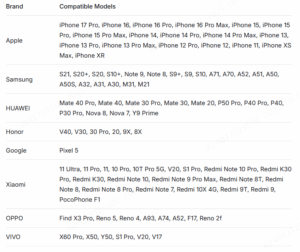

Brand/Model LARK M2 Camera Version LARK M2 Mobile Version
DJI Action 3/4 Connect via Osmo Action 3.5mm Audio Adapter Action 3/4 Connect via USB-C port directly
DJI Pocket 2/3 Connect via Do-It-All Handle 3.5mm Port Do not support
GoPro 10/12 Connect via 3.5mm Mic Adapter Do not support
Insta360 X3/ACE Pro Connect via Mic Adapter 3.5mm port Do not support
