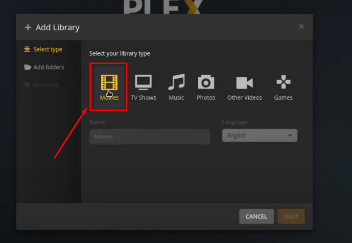

  • Step 16: Select ‘Add Library’ and click the ‘Movies’ icon.

  • Step 29: Click on any one of the libraries, such as ‘Movies,’ to confirm none of the titles are missing.
  • Step 30: Then, click on the ‘Settings’ icon.
Choose the ‘Server’ tab and click on the ‘Sign Out’ button.
  • Step 31: After doing that, click on the ‘Claim Server’ button.
  • Step 32: Lastly, click on the three dots next to any library name and choose the ‘Scan Library Files’ option.
Restart your computer and enjoy playing your favorite movies or shows without being annoyed with the “loading items to play” error.
