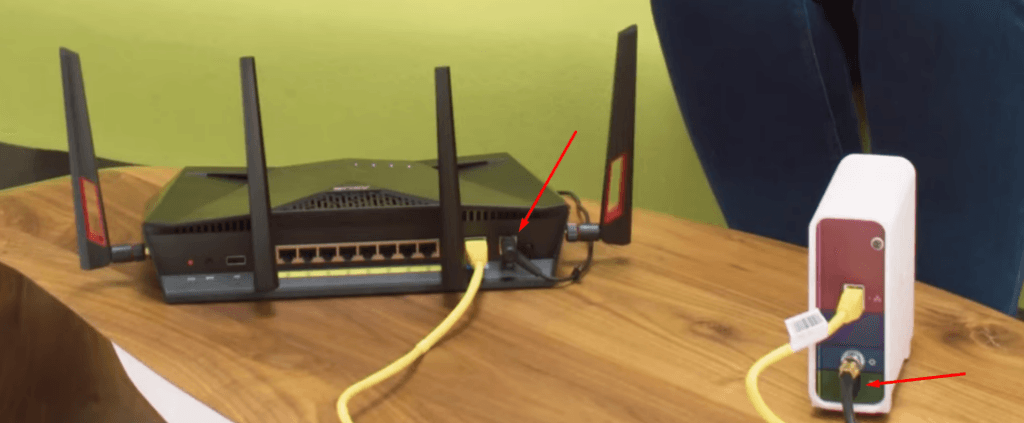

  • Step 1: First, unplug both your modem and router from the main power source. To do that, simply disconnect both devices by removing the power cables. Once done, wait at least 30 seconds to continue with the next step. It will help them cool down.
  • Step 2: Grab your modem and plug in the power cable. If you’re not sure which of the two devices is your modem, you can identify it from the coax cable port, as you can see in the image below.
Wait for at least one minute before proceeding to step number 3.
  • Step 3: When you see the lights on your modem, like this.
It means the device is turned on. So, plug in the power cable in your router and wait for at least 120 seconds to let the router completely restart.
