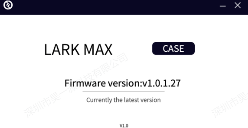

Mac PC Upgrade
1.Open the upgrade tool[LarkMax_CASE_Upgrade] in [Box_for_Mac]
2.Connect the charging box to the Mac PC.
3.After connecting the Box, it will be recognized, and then click [Yes] to do the upgrade.
Note: Don’t unplug the USB cable until it upgrades successfully. (The box indicator light will be off for about 5-10s when upgrading)
