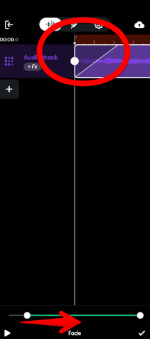

  1. From the pop-up, choose the Fade option.
  1. To apply a fade in at the start of the recording, move the dot on the left side of the screen toward the right. A diagonal line will appear, indicating the whole section where the fade in will occur. The more you move the dot to the right, the longer the fade in duration.
  1. To create a fade out at the end of the recording, slide the dot on the right side of the screen toward the left. This will also show a diagonal line over the fade out area. The more you drag the dot to the left, the longer it takes for the audio to fade out.
