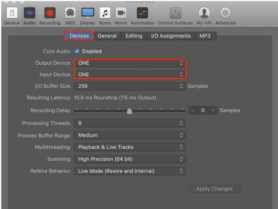

Step 3: Ensure the appropriate audio input device is chosen under the “Devices” tab in the Audio Preferences window.
choose devices
Step 4: Select the appropriate input device from the list if it still needs to be chosen.

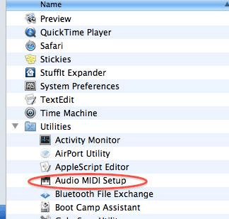

Step 1:Navigate to “Applications”> “Utilities”> “Audio MIDI Setup.”
audio midi setup

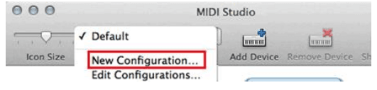

Step 3: In the Audio Devices window, click “Audio Devices” from the top menu and pick “New Configuration.”
choose new configuration option

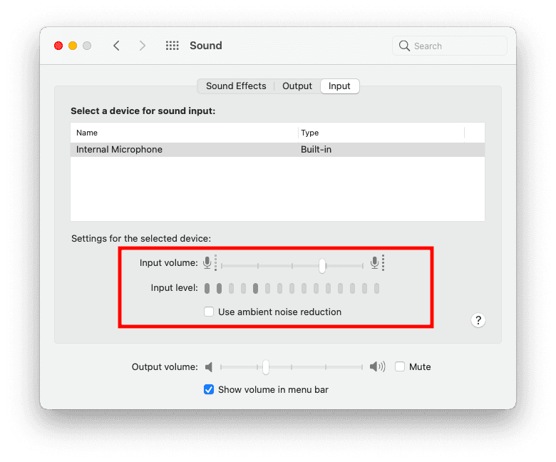

Step 3:Verify that the appropriate input device is chosen on the “Input” tab. Try increasing the input volume to ensure the level isn’t muted or too low.
choose input volume
