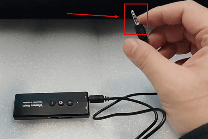

  • Step 3: Once the transmitter and speaker are paired, put a 3.5mm jack cable in the TX port of the device.
  • Step 4: Now, add the other end of the cable to your computer’s 3.5mm female jack. It is the same hole where you plug in your wired speaker.
  • Step 5: Find the “Mic In” jack on your computer, and insert the 3.5mm jack of the wired microphone.
