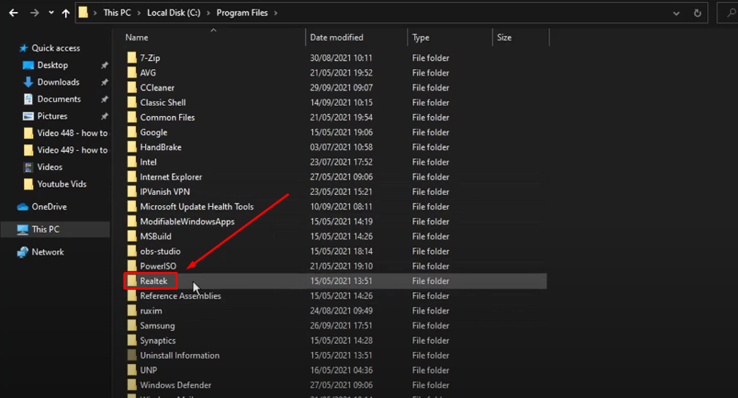

  • Step 1: Click on the “Start” button, search for “This PC” and click on the app
  • Step 2: Now, choose the drive where all of your Windows and software files are installed by default. In most cases, the “C” drive consists of all the essential files. So, double-click on the “Local Disk C” to view the folders
  • Step 3: Navigate to the “Program Files” folder and double-click to enter it
  • Step 4: Since this folder contains all the software folders, scroll down to find the “Realtek” folder and open it
  • Step 5: Enter the “Audio” and “HDA” folders
  • Step 6: Scroll down and click on the Realtek HD Audio Manager icon to open this software

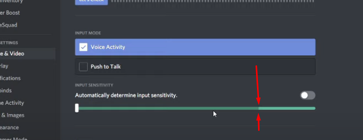

Fix 6: Adjust Input Sensitivity on Discord
If your Discord is still picking up YouTube audio, you can try one more hack to mitigate this problem. Although it may not be a permanent fix, it can provide ease of using YouTube while you’re interacting on Discord. With this method, you can adjust the input sensitivity of your microphone to stop Discord from capturing sounds below a specific point.
  • Step 1: Play any video with audio on YouTube and keep its volume to 50%
The concept behind this instruction is that your YouTube’s volume should be lower than the volume of your microphone.
  • Step 2: Open Discord and click on the small “gear” icon to enter User Settings
  • Step 3: Select “Voice & Video” from the “APP SETTINGS” menu on the left sidebar menu
  • Step 4: Scroll down to the “INPUT SENSITIVITY” section. You will see a sound bar (straight line) with an adjustable pointer positioned at the beginning like this:
The “light green” area will be constant, while the “dark green” line will increase and decrease as you speak in the microphone.
  • Step 5: To check if Discord is listening to your YouTube audio through your mic, mute the microphone and analyze the dark green line. Ideally, it should have disappeared since you have already muted the microphone, and there is no sound source that intrudes on the microphone. But you may notice that the green line still exists. However, this time, the intensity is low. Therefore, this is the sound of your YouTube audio that Discord is picking up.
  • Step 6: So press and hold the pointer and slide it to the point where Discord identified the sound even when the mic was mute (the previous screenshot should be the reference point)
  • Step 7: Once done, Discord will only capture that sound that is found in the green area (which is your microphone audio). At the same time, Discord will avoid picking up audio in the orange area (which is your YouTube audio) after adjusting the pointer
In this way, you can use Discord without letting it pick the sounds of your YouTube videos. However, you may need to resolve the problem permanently.
