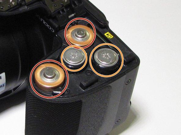

1. Double Check Battery Insertion
  • Confirm the battery has been inserted correctly. Even being a little bit out of alignment can cause these issues.
  • Open the battery door, remove the battery, and put it back in correctly.
