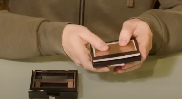

Scenario 2- Film Jam
Film may be stuck in the ejection mechanism. Follow these steps to address and resolve this flashing red light issue:
Step 1: Open the camera’s back by locating the button.
Step 2: Check for the irregularities that may be causing jam.
Step 3: Remove the jammed films if any, and close the door and turn the camera back on.
Step 4: If the issue persists, remove & reinsert the film pack.
