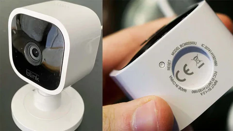

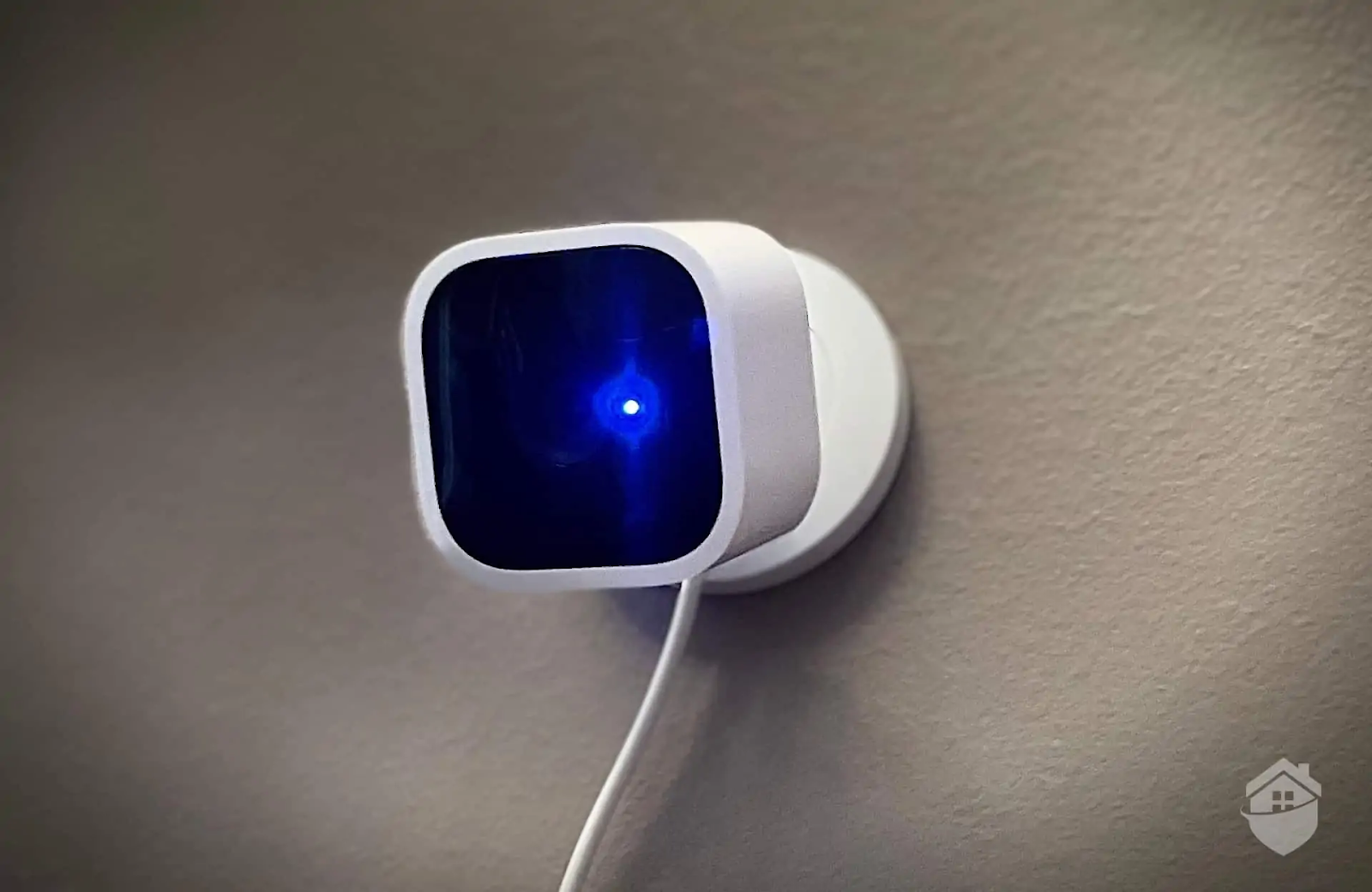

Blink Mini and Mini 2
The Blink Mini and Mini 2 have a neat appearance, so you may not find the reset button easily. It may take a minute to find it.
Here’s how to soft reset the camera:
  1. Keep the camera plugged into power.
  1. Flip the camera to locate the reset button or remove the mount to find the button, depending on your model.
  1. Get a paperclip to hold down the reset button for about 5 seconds.
  2. Let go when the LED light starts flashing slowly in blue.
This brings the camera back online without affecting your stored preferences or settings.

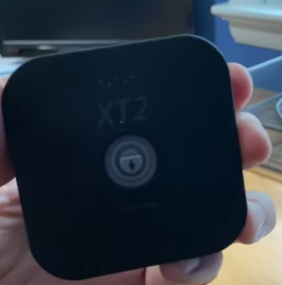

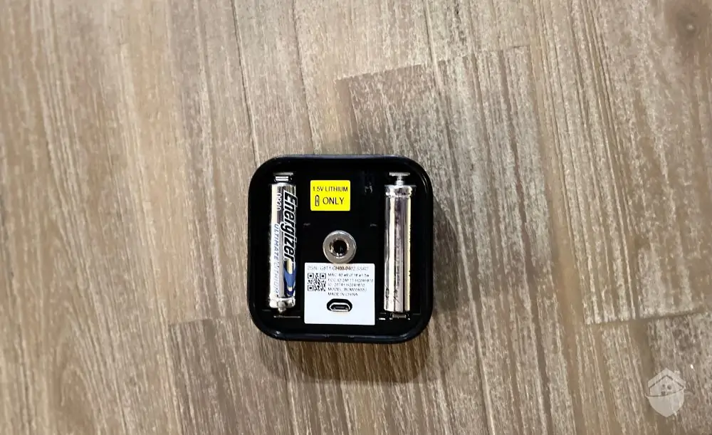

Blink Indoor, Outdoor, XT, and XT2
These models don’t have a dedicated reset button. Instead, a simple power cycle can work wonders.
To soft reset these models:

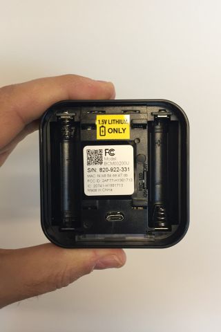

  1. Remove the batteries from the back of the camera.
  1. Wait 10 seconds to let any lingering memory clear.
  2. Put the batteries back in and wait for the camera to power up.
  1. Wait for the blue light to start blinking. It is an indicator of reset.
This method is ideal when the camera stops responding or disconnects without warning. It resets the device’s temporary memory without altering your saved configurations.
These are the only Blink cameras with a dedicated reset button that allows for a factory reset.
To factory reset your Blink Mini or Mini 2:
  • Keep the camera plugged in.
  • Locate the reset button.
  • Press and hold the button for about 30 seconds using a paperclip.
  • You’ll see the LED flashing red and then a steady green.
  • Release the button when the light turns blue.
That’s it. Your camera is fully reset and ready to be re-added through the Blink app.
Blink Outdoor, Indoor, XT, XT2, and Video Doorbell

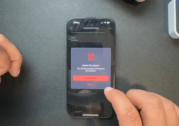

These models don’t support a true factory reset from the device itself. There’s no reset button like on the Minis. So, you have to remove the device from your Blink account, which effectively resets its connection.
To factory reset non-Mini Blink models:
  • Open the Blink app.
  • Locate the device you want to reset.
  • Tap the Settings icon in the top right.
  • Scroll down and choose “Delete Device”.
  • Confirm when prompted.
Once it’s deleted, the camera is unlinked from your account and can be added to a new one or set up again from scratch. Just note: if the camera is still registered to someone else’s Blink account, it cannot be reactivated until they remove it first.

Replace the batteries if your camera is still misbehaving. It may not indicate a low battery through the app, but weak batteries may contribute to poor camera performance. If it’s a battery-operated Blink model, then replace the batteries with fresh non-rechargeable lithium AA batteries.
