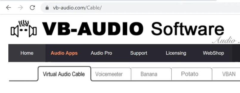

  • Step 1: You need Virtual Audio Cable to enable the audio. Download the VB-Audio application from here: https://vb-audio.com/Cable/. Then, install it on your machine.
  • Step 2: After installing the software, it will create two new virtual audio devices in your machine. One will be a virtual speaker named cable input. And the other will be a virtual mic named cable output.

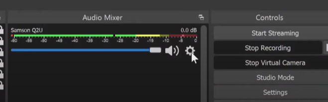

  • Step 6:  Now, you need to select the sources to monitor. For this, go to the Audio Mixer settings. It is the small gear icon at the bottom right corner of the Audio Mixer Window in OBS. Then, select Advanced Audio Properties.
  • Step 7: You will get a list of all the audio sources connected to the OBS. On the right side of the window, you will see Audio Monitoring options.
  • Step 8: Click the drop-down menu beside your microphone icon. Select Monitor and Output from there. Then, click Close.

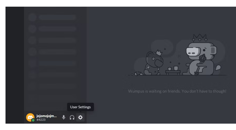

Open Discord and click on Settings at the bottom left corner of the screen.
Once the User Settings window shows up, select Voice and Video from the left sidebar.
If you click the Input Device drop-down menu, you will see a list of all the microphones available to the system. Select the virtual audio cable from there.

Go to Discord and click the small gear icon at the bottom left corner.
Select the Voice and Video tab on the left.
Scroll all the way down and click Reset Voice Settings. It should reset all the settings to default and your mic should work fine now.
