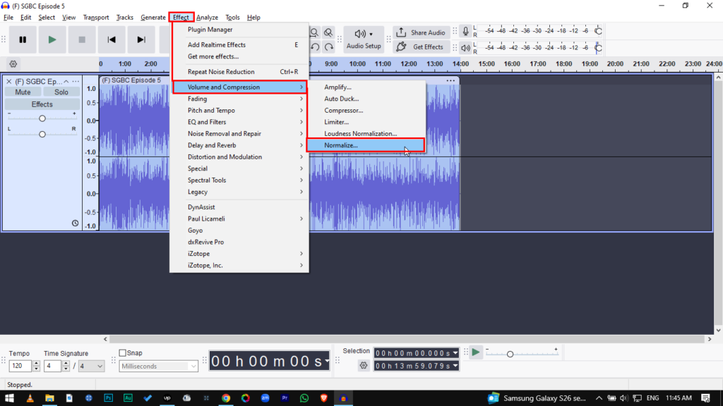

  1. Select Your Track: Click the track header or press Ctrl + A (Windows) / Cmd + A (Mac) to select the entire file.
  2. Open the Effect: Go to Effect > Volume and Compression > Normalize.

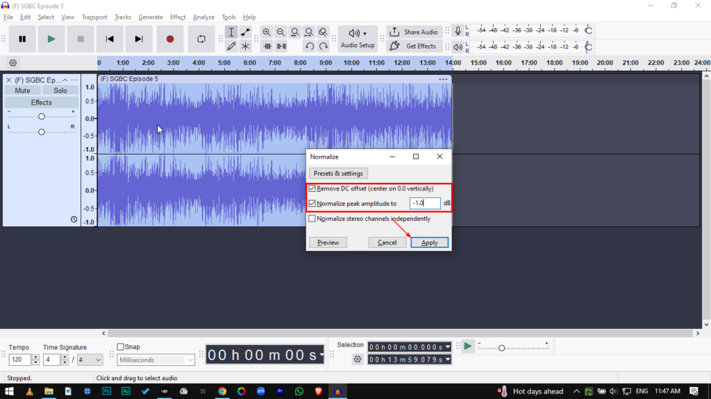

  1. Remove DC Offset: Make sure “Remove DC offset” is checked.
  • Why? DC offset happens when your waveform isn’t centered on the 0.0 line. Leaving this unchecked can cause clicks and pops during editing.
  1. Set Peak Amplitude: Enter -1.0 dB in the “Normalize peak amplitude to” field.
  2. Apply: Click Apply.

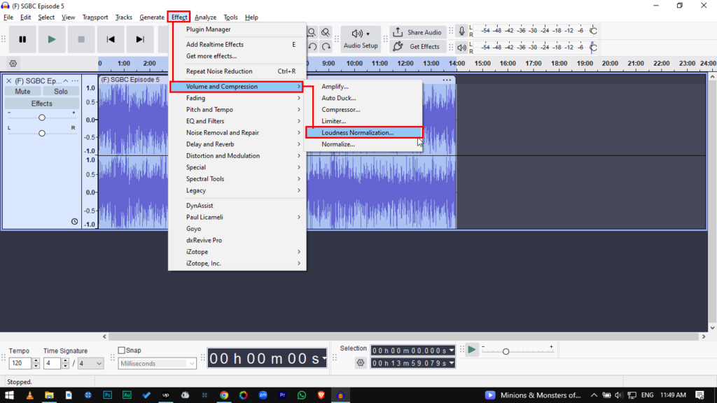

  1. Select your audio track (Ctrl + A / Cmd + A).
  2. Go to Effect > Volume and Compression > Loudness Normalization.

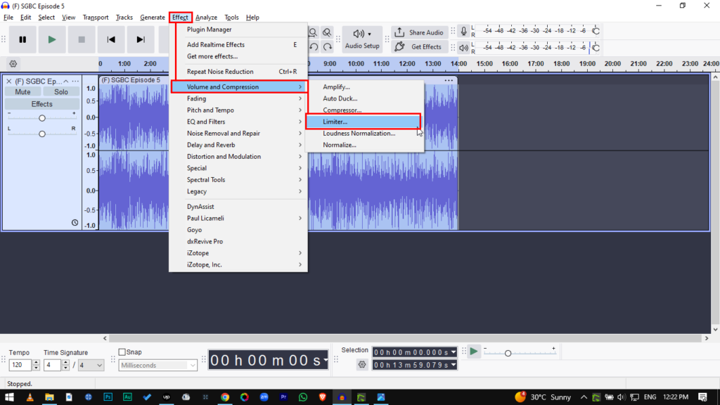

  1. Use a Limiter: Go to Effect > Volume and Compression > Limiter Set it to “Threshold” and choose a limit (e.g., -3.0 dB). This will “shave off” the loudest spikes.
  1. Re-Normalize: Now that the spikes are gone, run the Normalize effect again. You will notice the overall volume increases significantly.
